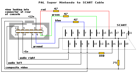

Super Nintendo
For some unknown reason the RGB output circuits differs between the NTSC and PAL consoles. As a result the cables are different too (though I somehow doubt Nintendo had any intention of releasing a SCART lead for the NTSC SNES).
Super Nintendo.
Super Nintendo.
Proprietary A/V connector. Pinouts: 1 red video, 2 green video, 3 +12V DC, 4 blue video, 5 ground, 6 ground, 7 luminance, 8 chrominance, 9 composite video, 10 +5V DC, 11 audio left, 12 audio right. RGB output circuit: here

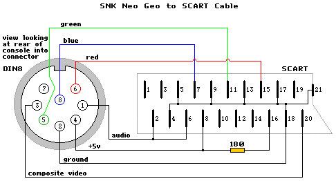

SNK Neo Geo
SNK NeoGeo.
SNK NeoGeo.
Female 8 pin "C" DIN connector. Pinouts: 1 audio mono, 2 ground, 3 composite video, 4 +5V DC, 5 green video, 6 red video, 7 composite sync, 8 blue video. RGB output circuit: signal comes out a CXA1145/MB3514, through a 75 ohm resistor and a coupling cap.

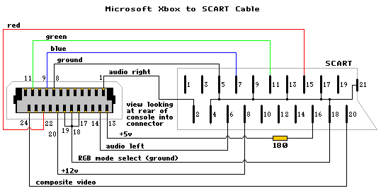

Microsoft Xbox
MicroSoft Xbox.
MicroSoft Xbox.
Propriety connector. Pinouts: 1 audio right, 2 audio ground, 3 SP-DIF digital audio, 4 vertical sync?, 5/6/7/8 ground, 9 video output A (blue), 10 video ground, 11 video output B (green), 12 video ground, 13 +5v, 14 audio left, 15 audio ground, 16 horizontal sync?, 17/18/19 video mode select (ground all three for RGB), 20 +12v (RGB Status), 21 video ground, 22 video output C (red), 23 video ground, 24 video output D (composite video). Different audio/video configurations are selectable by maniplating the three video mode select pins (17, 18 and 19). See the Gamesx Xbox pinouts page for more info on this. The DC voltage on pin 20 will drop to +5v for widescreen mode.

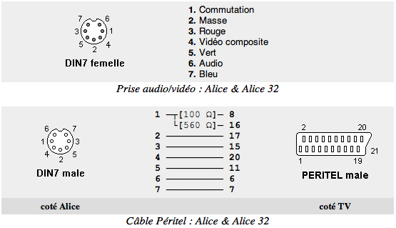

Matra & Hachette ALICE & ALICE 32
Diagrammes d'ALICE et ALICE 32.

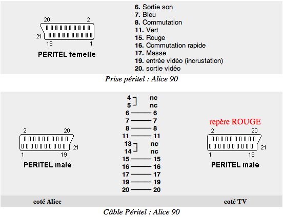

Matra & Hachette ALICE 90.
La réalisation du câble péritel de l'Alice 90 exige d'acquérir un câble du commerce de bonne qualité et respectant les normes de fabrication attendues, à savoir que les liaisons des broches 7, 11, 15, 19 & 20 doivent être réalisées avec du câble coaxial de faible diamètre (~3mm maxi) et d'impédance égale à 75 ohms. Pour la broche 6, normalement il faut un câble blindé basse fréquence. Les prises SCART utilisées doivent, évidement, être démontables.
Attention: Les câbles à bas prix ne sont pas adaptés car en général des économies sont faites pour les liaisons qui deviennent des liaisons simple fil ou dont le câble coaxial utilisé est de mauvaise qualité et présente des caractéristiques techniques (impédance et atténuation) en dehors des normes.

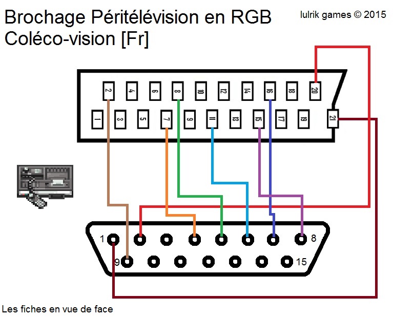

J’espère que ça pourras aider, je l'ai réalisé au megomètre sur mon propre câble.
